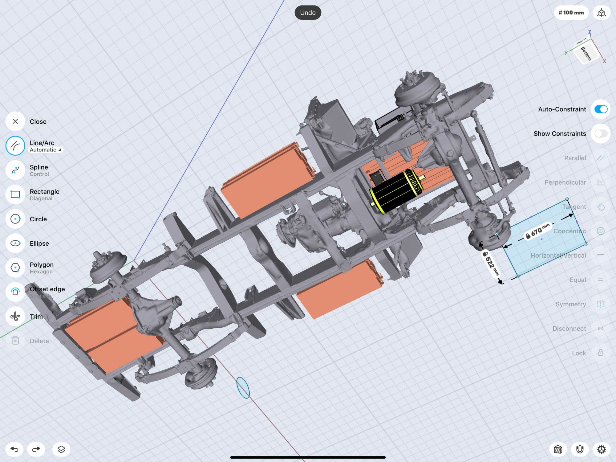

Dave’s team is up against no small challenge. They’re taking an old car that’s hand-built with limited precision and connecting it to precision CNC and laser cart processing. The placement of old parts on the car are so unpredictable, that finding the bolt holes between the chassis and body can already become a practice in drilling.

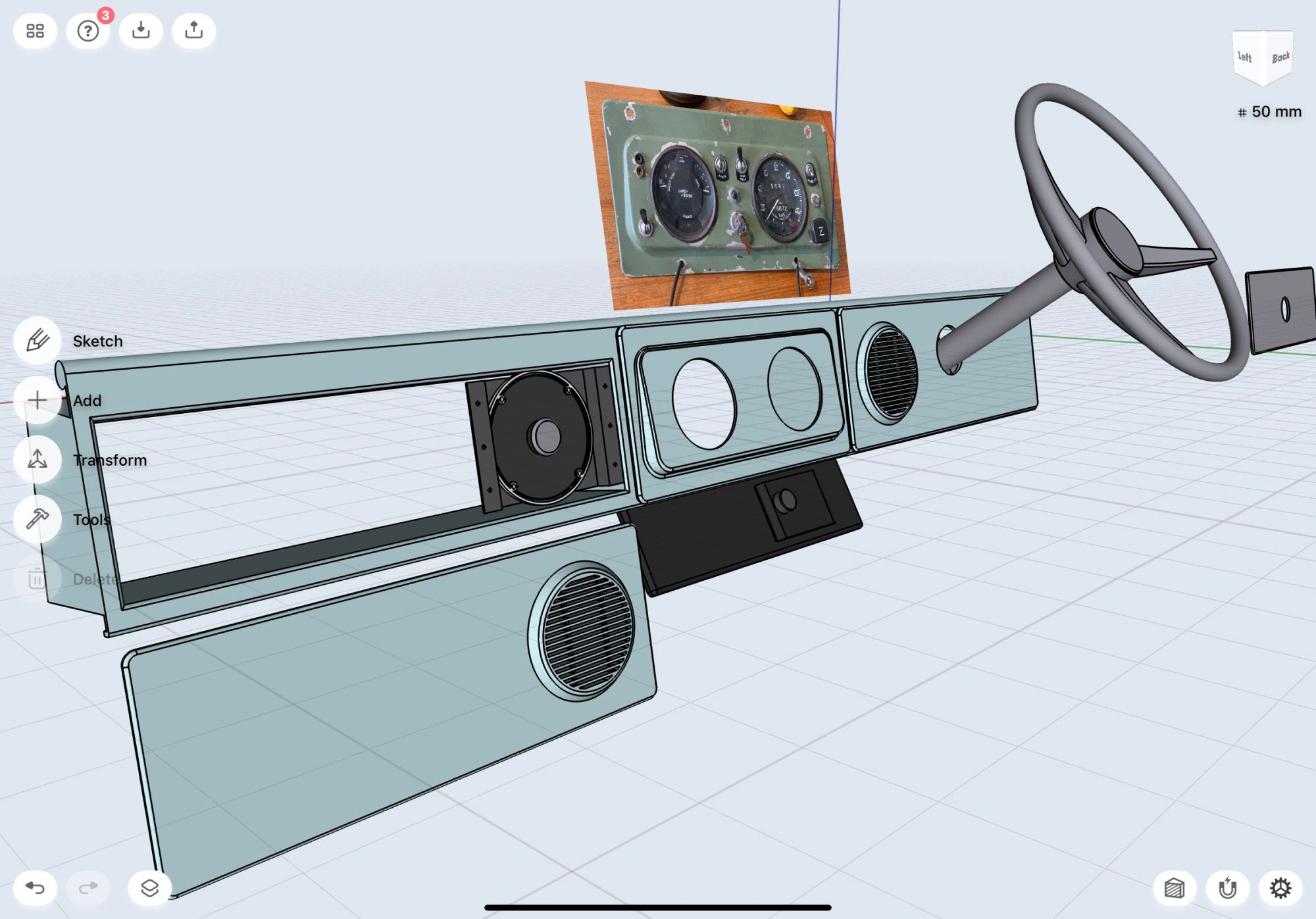

To solve design challenges, the team uses a combination of force and wit. Hammering things until they fall into place can at times become a necessity, but for parts that can be replaced, they’ve begun using Shapr3D as a concept design and CAD tool to create custom parts in the workshop.

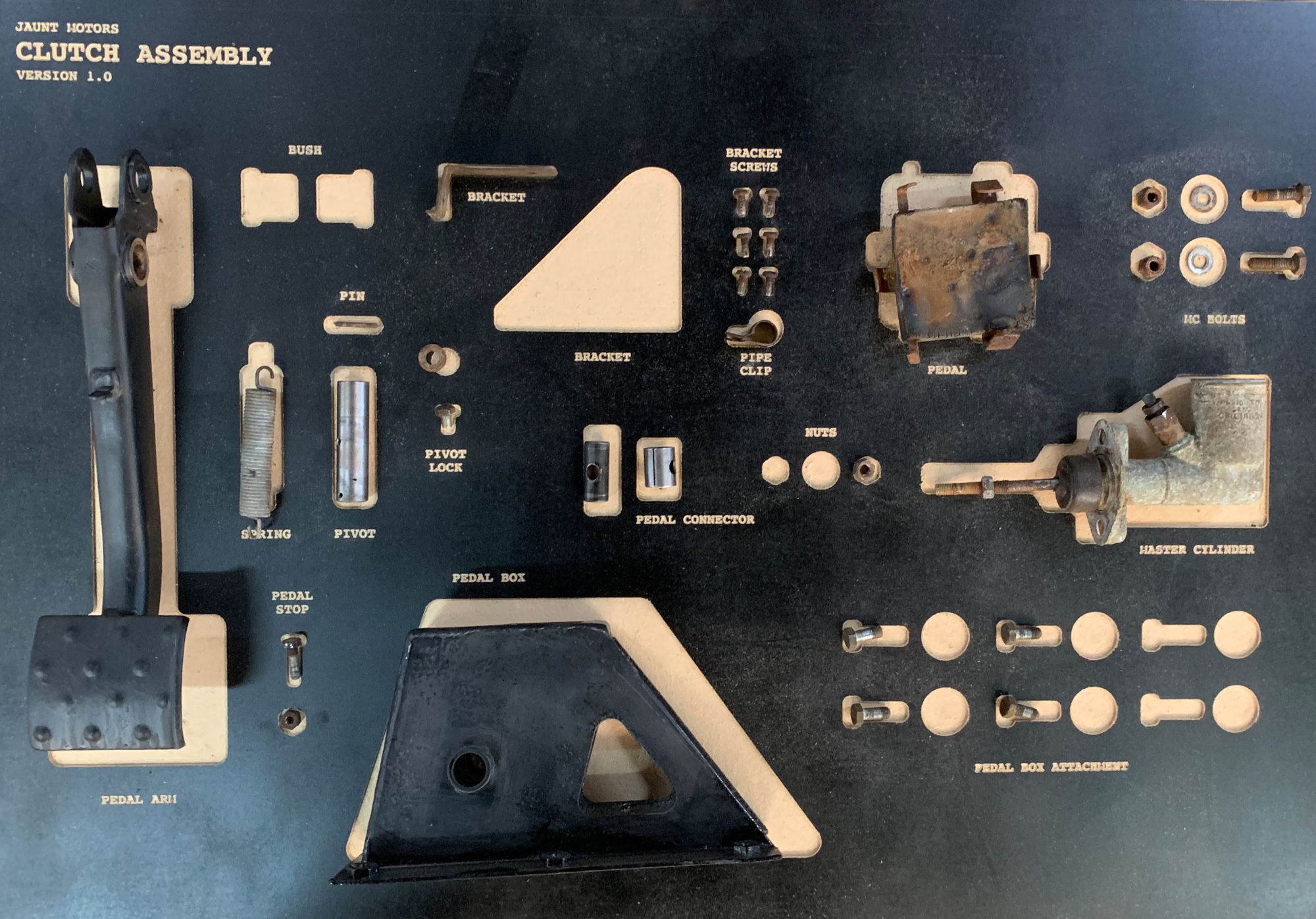

Whether they're prototyping parts themselves by CNC milling plywood pieces or getting the finals fabricated by a production partner, each step is designed to move the process from one-off, hand-built parts to repeatable designs that can work across over 40 years of Land Rover designs.

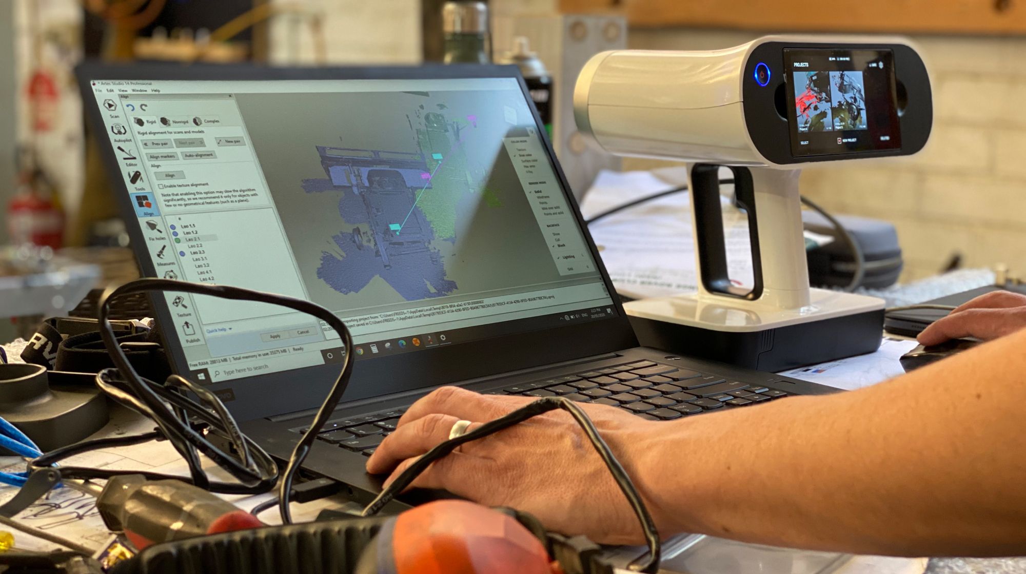

Many of the models from the ‘60s and ‘70s don’t have working CAD files, so they work with a team that 3D scans the vehicle bodies, then import them into Shapr3D and work in the electric batteries and fixtures to show customers what the end result will look like.

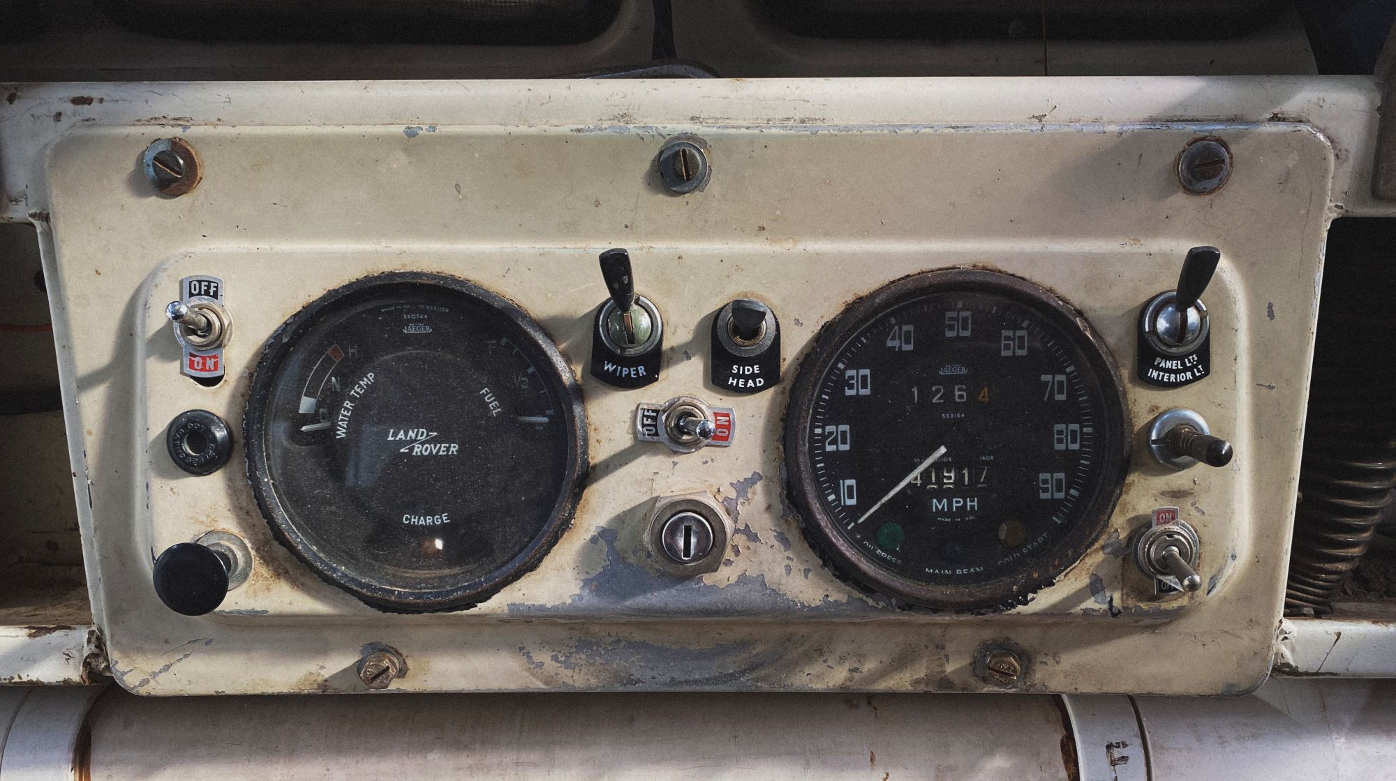

The dashboards on the really old pre-1970 Land Rovers were largely big hunks of metal with gauges and ignition in the center. The interior design itself is really simple, basically just the other side of the sheet metal exterior.
The design language of the car itself is strange, the way that the functions are described aren’t the most friendly. Many of the classic rigs don’t have symbols, just text, or unlabeled switches that drivers ‘know’ how to work. Between the mystery handling and the novelty of electric vehicles, the team had to work hard to make the whole ride more approachable.

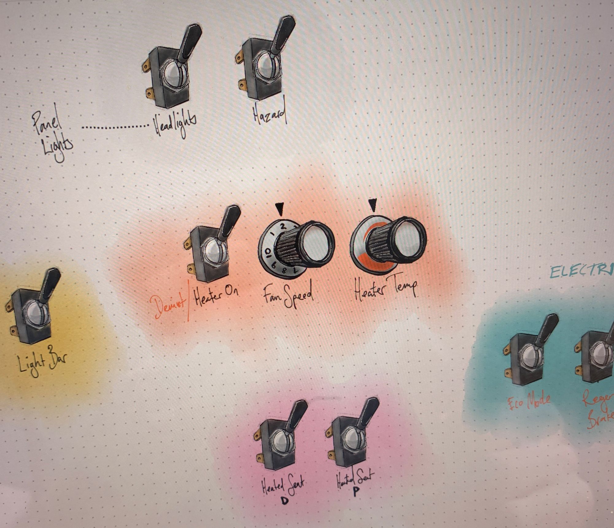

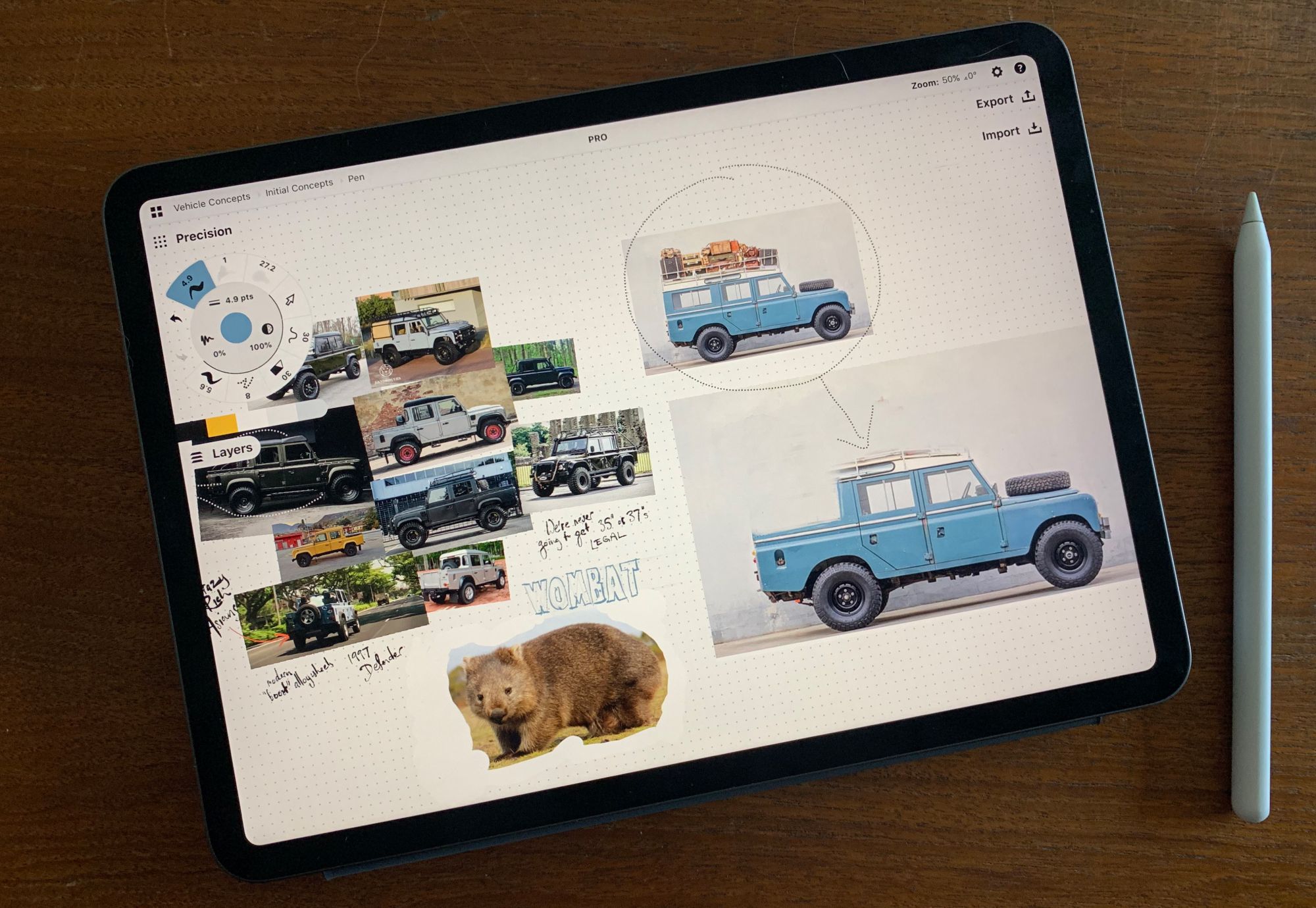

With this philosophy in mind, Dave goes into the Concepts app to create initial sketches and brainstorm. He likes the ability to compile references and look at things in a big picture way in the app. After some thoughts are sketched, he’ll move into Shapr3D.
“I want to see in 3D, very quickly. You can sketch out all you want, but when you’re going into physical manufacturing, you can approximately draw a three mm gap in the context of a five mm thick aluminum, but it still won’t click. So getting into 3D very quickly was the goal.”

In the dashboard, there were elements that were CNC milled out of thick aluminum stock while other elements were out of sheet metal. Dave exported those as models and pull them into Fusion. The thicker machine plate directly translated, but the sheet metal components he redraws in Fusion where the sheet metal tool is easy to use and he can export 2D drawings.
The companies they work with to get things machined use AutoCAD, so Dave exports Shapr3D files, create drawings out of them in Fusion, and sends them to the manufacturers as PDFs. With their own CNC mill, they often export directly from Shapr3D to cut parts before sending them to the workshop.

The team is aiming to get a 1:1 3D model of the vehicles they build, so all of the components and new parts have 3D models as well that are continuously updated. They use Shapr3D to do that, updating models on the factory floor every day.
